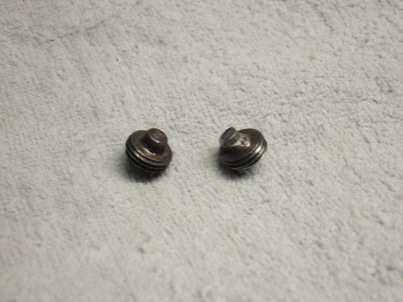

On stripping it down I found with the stop button out Part 8, therefore Part 7 and 2 wouldnt slide in and out of one another scratch as you can see here Part 8 is knackered after tightening in with fingers it was a bugger to get out I used an adjustable spanner very carefully Wink
Here it is against it replacement. Now not made I was lucky to get one - Thanks Andy @ Hutsons Cheers

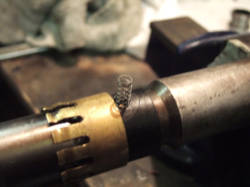

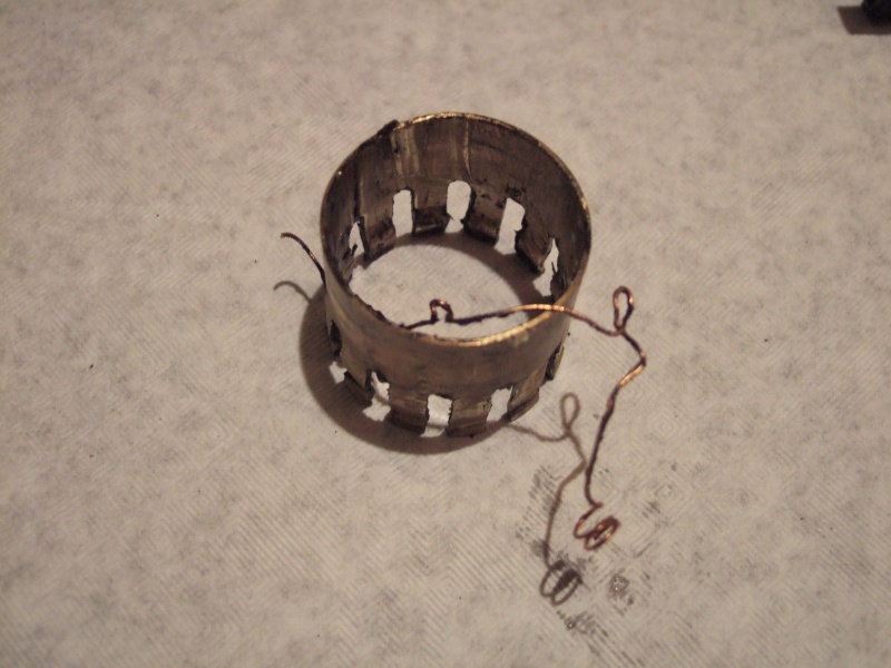

I slid the slip ring part 20 off the end and the spring and as you can see the spring has got caught and undone
Luckily I had a spare (the old one) so with everything stripped down
Give it all a good grease when re assembling (keep the rust at bay Smile )
Then putting the spring back in carefully:-
Don't let go of the spring to early or it will ping out Embarassed
So after boths end are back together slide it in Part 1 the Outer Tube Assembly and refit back in the car
Job then sorted grin
Lesson - Make sure the spring is in the hole properly and not caught Sad
