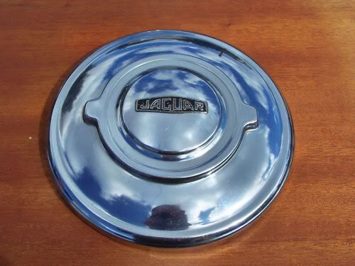

While on the subject of wheels I read that MK10 & 420G
have different hubcaps do you have the right ones Question
Again, if anyone can upload a picture of the 2 versions
that would be good Smile
jag420g
Resident Mk10\420G Guru
Posts : 445
Location : Melbourne, Australia
PostSubject: Re: Mk10/420G Wheels   Thu Nov 04, 2010 7:44 pm
Yes, Clive you are correct,
The hubcaps on the Mk10's were the conventional type with the word Jaguar across the center.
The 420g had the Jaguar face round badge.

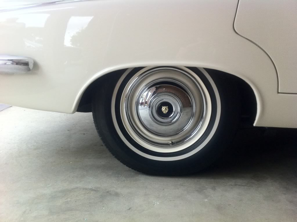

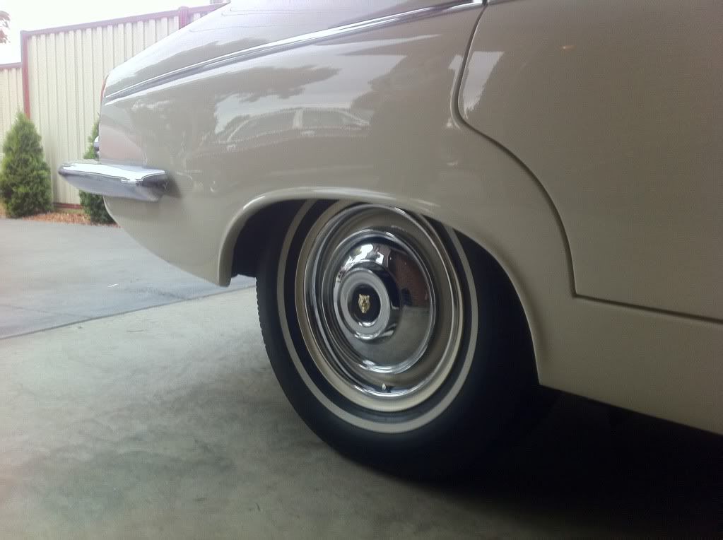

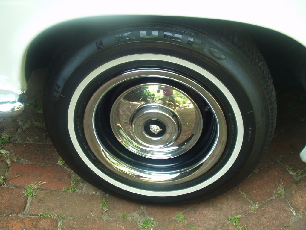

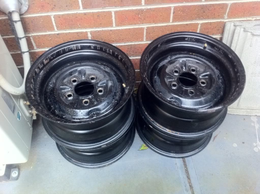

Well people, my original wheels are finally on. They were sourced, sandblasted and then powder coated.
I went from these deep dish bad boys (I dunno what the PO was thinking)
To this glorious result:
Thanks to all for your assistance highfive
CHARLES thanks3
